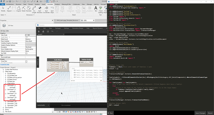

How can call Elements from the project browser (later i want place them!)
I can call them when they are placed, but can i call them “idealised” for later placing! f.e. they got placed when a family has a particularly value.

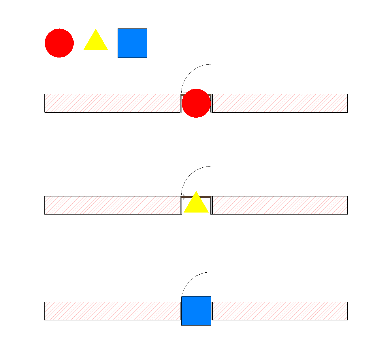

yes, i have symbols they have to be placed on doors.
the doors are in the view, but my symbols remain in the project-browser!
How can i “take” them via dynamo python
a option would place the instances type by type so i can collect them, but i would prefer the workflow to get the type and later i place them on the doors, the placement depents on different values ("Gelb", "Rot"...)
You should use:
WhereElementIsElementType()
instead of
WhereElementIsNotElementType()
Because you are search for FamilySymbols (better known as Family Types)
Another problem is that you will find System Families, I filter these away using a Try Except because they will throw an error if you query their “Family” property.
