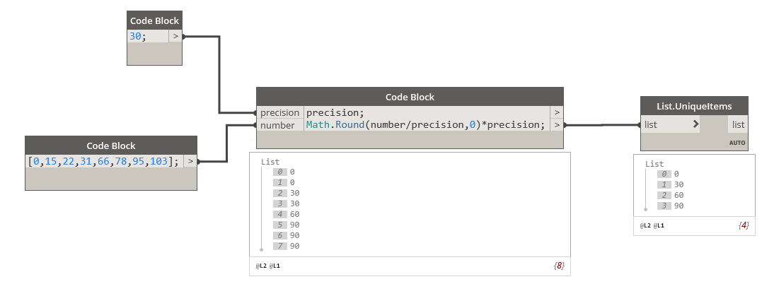

Hi, trying to reduce the numbers in a list By Roundup with a Range of 30.
Like this ?
Capture
