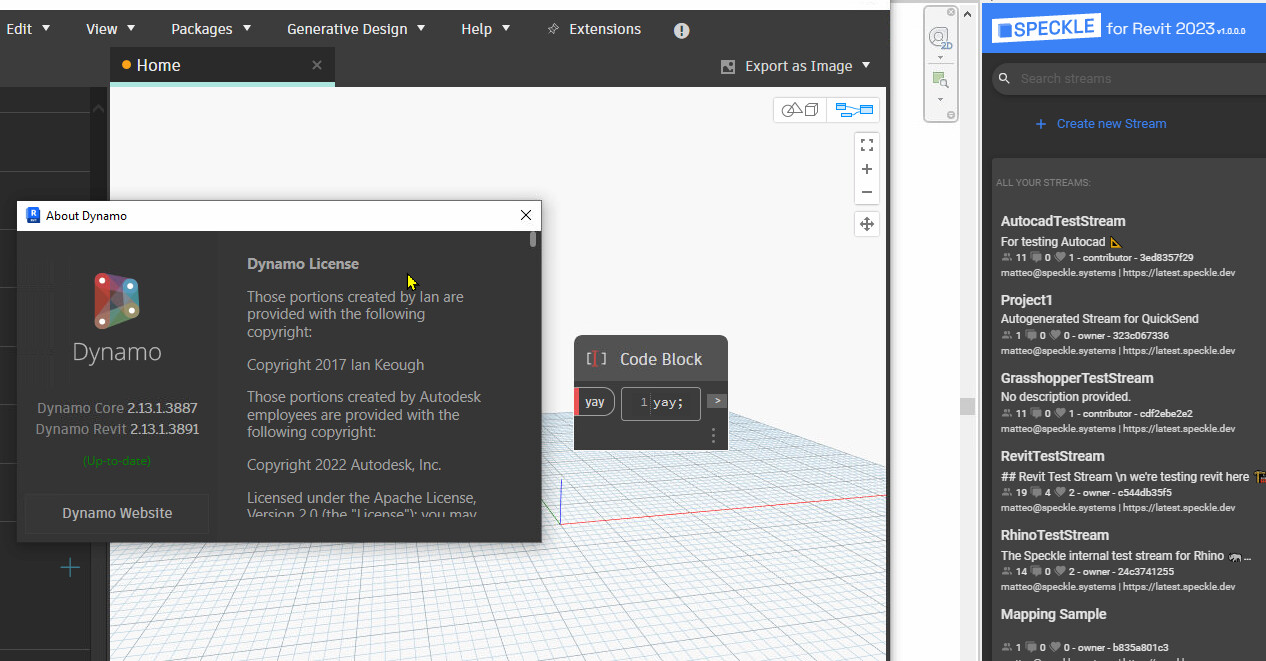

Hi i’m running the same version of Dynamo and just did a fresh (re)install (revit 2023 as a whole).
I have the same issue with the code Blocks, but disableling or uninstalling generative design doesn’t do the trick for me.
I also don’t have any other packages installed…
@jacob.small: I know this is a far strech but could there be a bug in the original source code of Dynamo (version 2.13.1.3891)? or is there an other known solution for this?

Hello @AlexanderVandenbergh …do you have speckle installed it gives problem,therestill are some conflict here…speckle works on it
try disable the speckle addin,you could try diroots addin manager for disable…ps…for me it isnt enough to diable GD

Speckle isn’t the only add-in which can cause the conflict. Even tools installed for other applications can cause the issue as they often ‘hook into’ the Revit application directories to get their exporters set up.
The journals and logs are the first step to to identifying the source of the issue.

I have Speckle 2.8 for Revit and Dynamo 2.16.1.27 in Revit 2023.1.1 and it is still a problem, after deactivate Speckle, I had access to the Code Blocks
Hey @jan.appelgryn please try disabling GenerativeDesign as described here.
Unfortunately this is the only workaround we can recommend, until we have more information on what the conflic is due to from the dynamo team.
I did not have Generative design activated, mine is working now, Thanks
