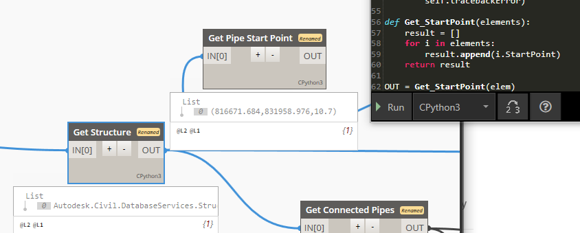

Hi does anyone know how to convert this to Dynamonodes.Pipenetworks.Pipe?
I think the first thing you’ll have to resolve is that the Python node outputs a structure, but it looks like you’re wanting it to output a pipe.
But apart from that, the classes that you’re dealing with are in the Civil 3D Toolkit, so you’d need to add those DLLs as references and then access the public constructor for a pipe (if there is one - I can’t remember).
