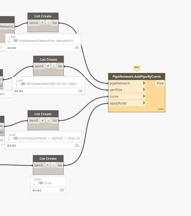

I am working with block reference. I have created a line using block reference. Now i want to convert that line into pipes. Using Addpipebycurve node but is not working for that type of case. Except that is working.
Error is → Warning: PipeNetwork.AddPipeByCurve operation failed.
Object reference not set to an instance of an object. In both the cases.

We can’t see the nodes. Please zoom in until you can read the node name and then export the workspace as a picture using the function in uppger right corner of the canvas.
Or even better, please share your graph.
The forum won’t allow me to attached a file being a new user and the image looks the same even zoomed all the way in. Here is the dropbox link.
I used both
But the result was same.
Just try in another dwg file.
I used this graph in another dwg file. and it is working fine. May be there is an issue with dwg file itself.
Same thing happened for me. I used the default drawing and called up a different pipe.
