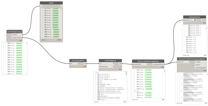

I am running into an issue using Archi-lab’s Collector.ModelGroupByName, which I am getting mostly empty list. Can someone explain what is causing that issue?

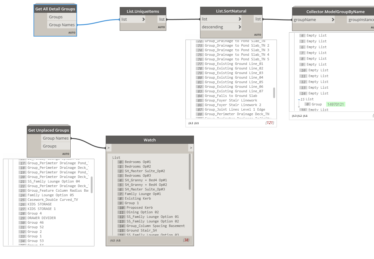

Those groups do have instances in the project, only a small handful of groups are currently unplaced shown in screenshot below;

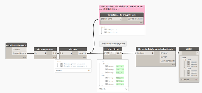

is actually from @john_pierson 's Rhytm package not from Archi-lab.net Even though its not my package I am sure there is nothing wrong with it. You are using a component from Archi-lab.net to collect all DETAIL groups, and then try to get their instances using a MODEL group collector. They are not compatible. There are two (2) different group categories: Detail, and Model. They are not the same thing. You can easily modify John’s node to collect Detail groups instances like so:
Here’s the code for the new collector:
import RevitServices
# Import RevitAPI
clr.AddReference("RevitAPI")
import Autodesk
app = uiapp.Application
#The inputs to this node will be stored as a list in the IN variable.
dataEnteringNode = IN
names = IN[0]
collector = FilteredElementCollector(doc)
groups = collector.OfCategory(BuiltInCategory.OST_IOSDetailGroups).WhereElementIsNotElementType().ToElements()
groupInstances = [[] for i in range(len(names))]
for index, name in enumerate(names):
for group in groups:
if group.Name == name:
groupInstances[index].append(group)
OUT = groupInstances
Here’s the definition:
detailGroupCollector.dyn (13.6 KB)
