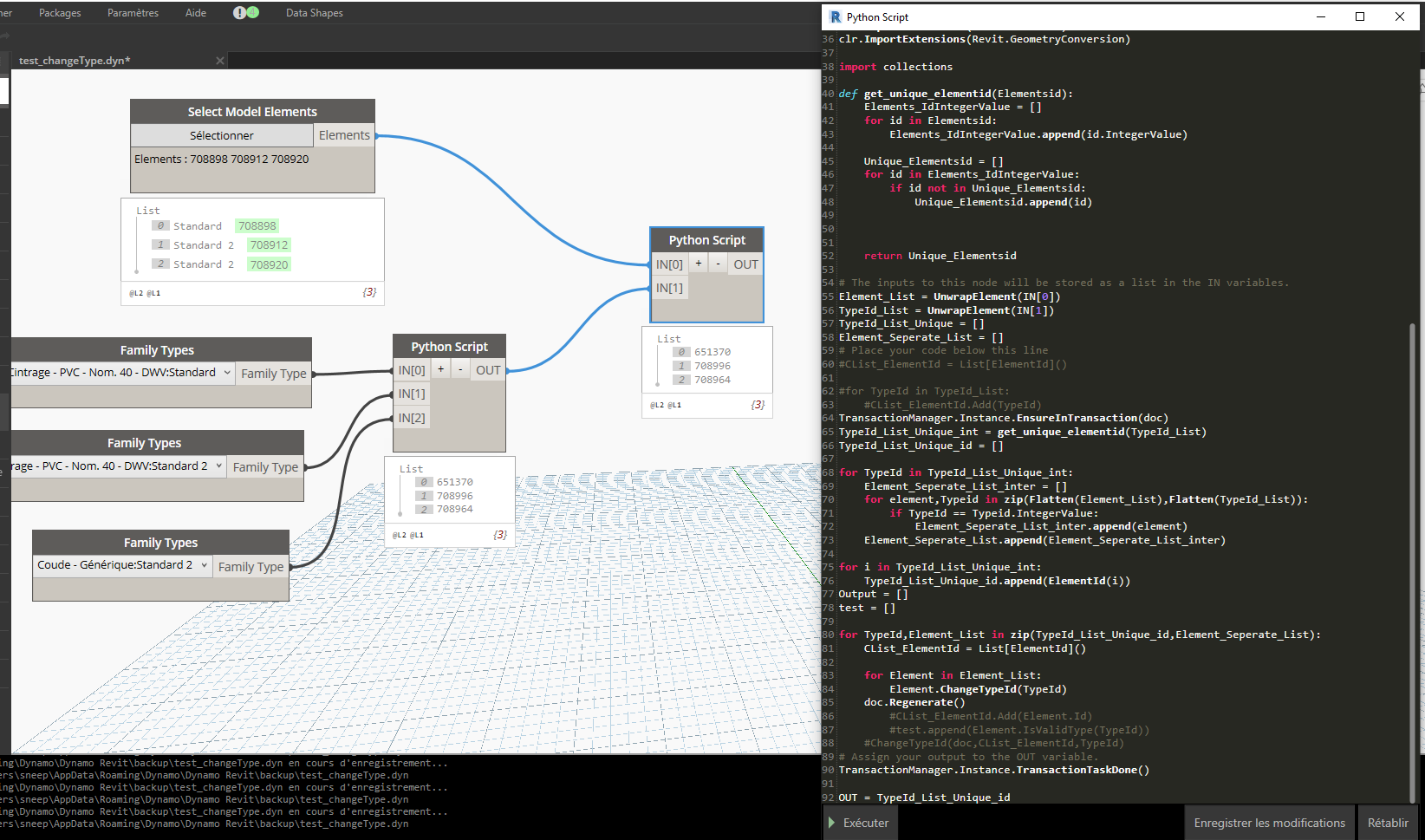

I am trying to change type id of a set of pipe fittings at once.I used the revit api method as shown below…anybody know how to apply this method?..now i am getting an error which says 'ChangeTypeId is not defined".
Hi All,
i tried to change family type of fitting one at a time using the methodElement.ChangeType(ElementId) but its giving me following error.
File “”, line 82, in
Exception: The referenced object is not valid, possibly because it has been deleted from the database, or its creation was undone.
Here is the full code

Hello @j.sunnyT6MVA
I don’t know the structure of your input lists, but your script works for me, what’s your Revit version? Can you share a sample file project?
Notes:
avoid writing the name of your variables in Title case format
It’s not necessary to convert ElementId to Integer to compare them
