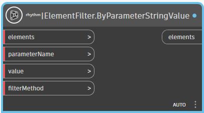

I would also suggest replacing your whole filter by boolmask section by:
from the Rhythm package.
List.FilterByBoolMask is very powerful and it doesn’t always apply to use the Rhythm node. But in this case it will be easier to filter them out
