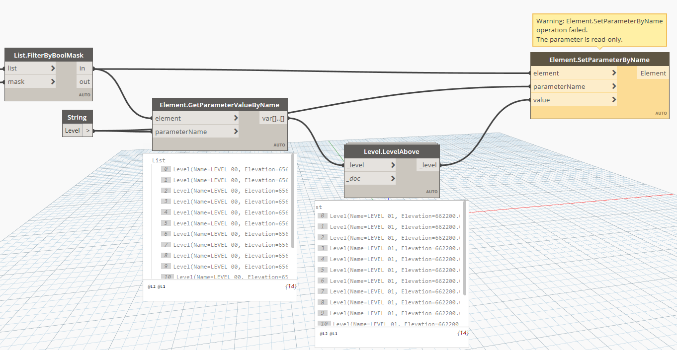

as the name suggests, i want to change the data associated with lighting devices:
as you can see the elements are on level 01, 02 and roof, but are referenced on level 00
manually i can go to each element and change the associated level and the “elevation from level” parameter is fixed automatically, maintaining the location of the element.
so i created a script that does exactly that, collect all elements, filter them, then change the level and here is where i encountered a problem:
is there a way around it? or am i going about the problem the wrong way?
Hi @NERDASORUS are you sure your lighning have a level parameter, probabobly its schedule level or reference level when you set the parameter
so sorry, you are correct, its a schedule level.
is there a way to modify it?
dont think so its buildin parameter…but you could try something here, if i understand :wink:

regarding the subject above would really like your input, i have searched and found that “Change Element Level” node does exactly that.
the problem is i need to use “levels” OOTB node for the level input, for some reason i cant use “Closest Level” node which is perfect for the workflow.
am i doing something wrong? why isnt closest level working?
Hi try something here and see if it could work
