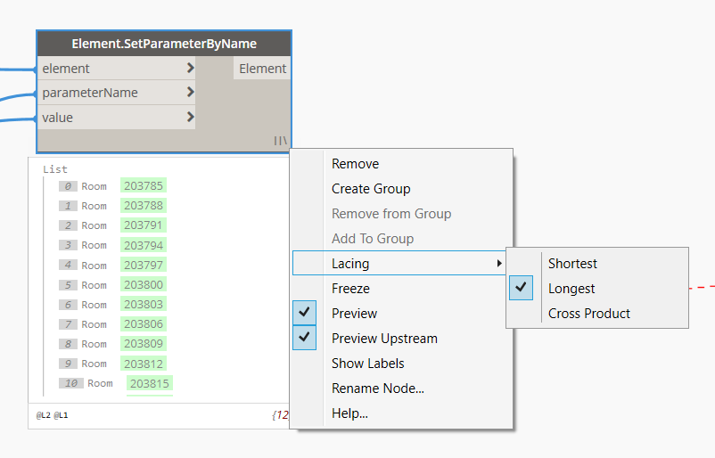

Hi Ivan,
You need to set the lacing on longest (le plus long) on the Element.SetParameterByName nodes.
