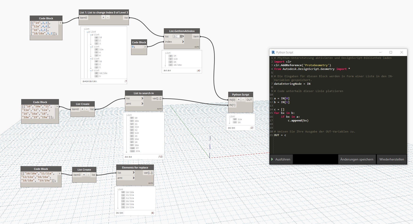

I have the following problem and need a little help.
I have a list “List 1” and ich need to search in another list if these are contained. If they are, then i need to substitute in the first list those elements with the equivalent of a 3. List.

Well, I’m not sure how to fix your python script, but it can be done with nodes thru the use of dictionaries.

HI
Tank you, but I think I made it own my own
But at the end i have just a little problem putting back the Elements to the start List. Can you help me?

manually set your last node to longest lacing instead of using auto.

Oh s__t, mine does not work correctly!
I take yours for testing

HI
It works perfect.
But how can I ignore the Warnings?

Good morning
I have the solution! I made it with Spring Nodes:
Thank you very much!
