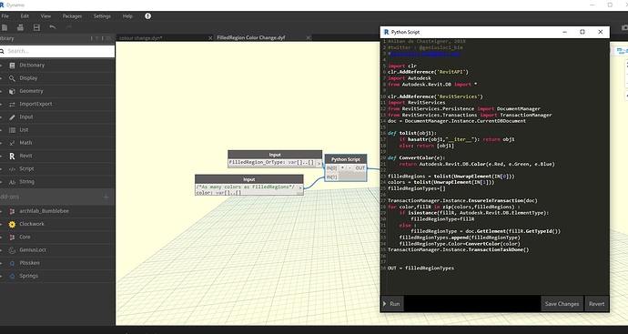

Hi, I am trying to change the colours of filled regions - I am using the genius loci package - filled region color change custom node, but when i feed in the filled region and colour, the node returns null. I have tried using hex colour code and RGB neither seems to work, can’t figure out where it is going wrong.
Any help appreciated!

It seems like iteration problem. Can you add a List.Create after watch node and connect it?
I tried on my side with Colorby.ARGB node and it works. Can you also try that?
UPDATE:
It is because of wraped elements… if you can update the python code of node like that:
@Alban_de_Chasteigner will update, too. I guess.
#Alban de Chasteigner, 2018

Please try with that new Python code, let’s see what happens…

You are right, when you try to do with FilledRegionType, Revit crashes…
i’m using revit 2020…
is it possible to adjust the python script further to deal with the new ```
‘ForegroundPatternColor’ in 2020?
I will have a go myself but am a python novice...
Can you try that one?

What is your goal?
To be sure; note the difference FilledRegionType and
FilledRegion(s) in the Element Types node.
Working!!
amazing thankyou
Thanks Deniz, I will update the node for Revit 2020.
Hello Alban, thank you for your efforts. The problem exists on 2019, too.
Hi @alina and @Deniz_Maral,
I updated the node. It now works with all versions of Revit.
I also added some optional inputs (pattern, masking and Line Weight)
Thank you very much Alban! Great work!
