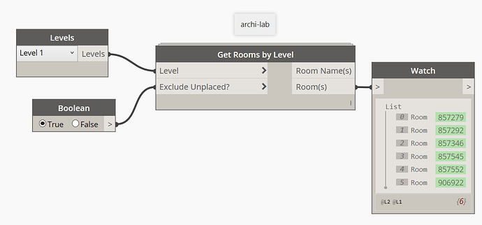

Try filtering rooms by level only. Then you can apply your room location point centering logic to just that subset of rooms.
This is the original, seems like I still need to select the boundary of those rooms as well, do u have any idea how? :slight_smile:
