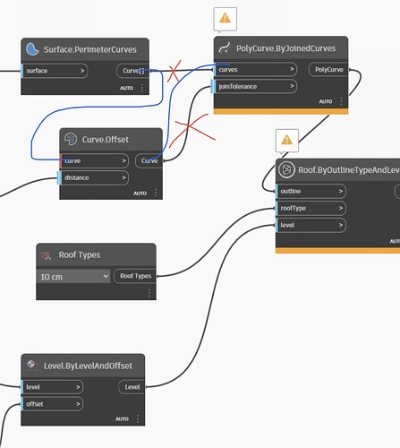

I need to offset the ceiling created from the floor face reference by a few centimeters. For regions where it stands out from the floor area, but it is not working with any tested node, and the error informs that; Curve joining produced more than one edge in the polycurve. A polycurve must have exactly one edge.
What you mean? How to fix?
Maybe try feeding the curves into a Polycurve.ByJoinedCurves node?
Sorry I’m not at my pc so can’t try it
Thanks for the attention. I tried to use the polycurve in several ways too, and it didn’t work either. It would be like this?
Try this?
So, I tried this one and it gave me this curve joining error.
You might need to join the curved before offsetting them. Try swapping the order of those two nodes.
Yes. It worked now, that’s exactly what it was. Thank you very much!
