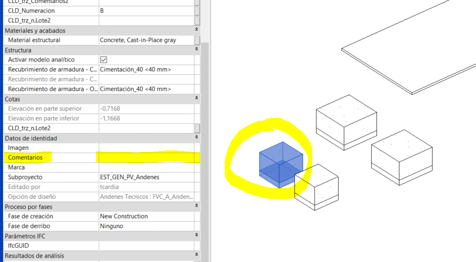

I need, through a Dynamo routine, that its Cartesian coordinate x-value appears in the element parameter “comments”

I’ve tried to do the routine with dynamo, the problem is that i can’t find the right function: “element.SetParametersByName” is just for type parameters but in need the same for instance parameters.

Element.SetParameterByName will work for whatever element you feed it. You’re feeding it the FamilyType so that’s why you can only set the type parameters. Feed it the FamilyInstance and you’ll be able to set instance parameters.

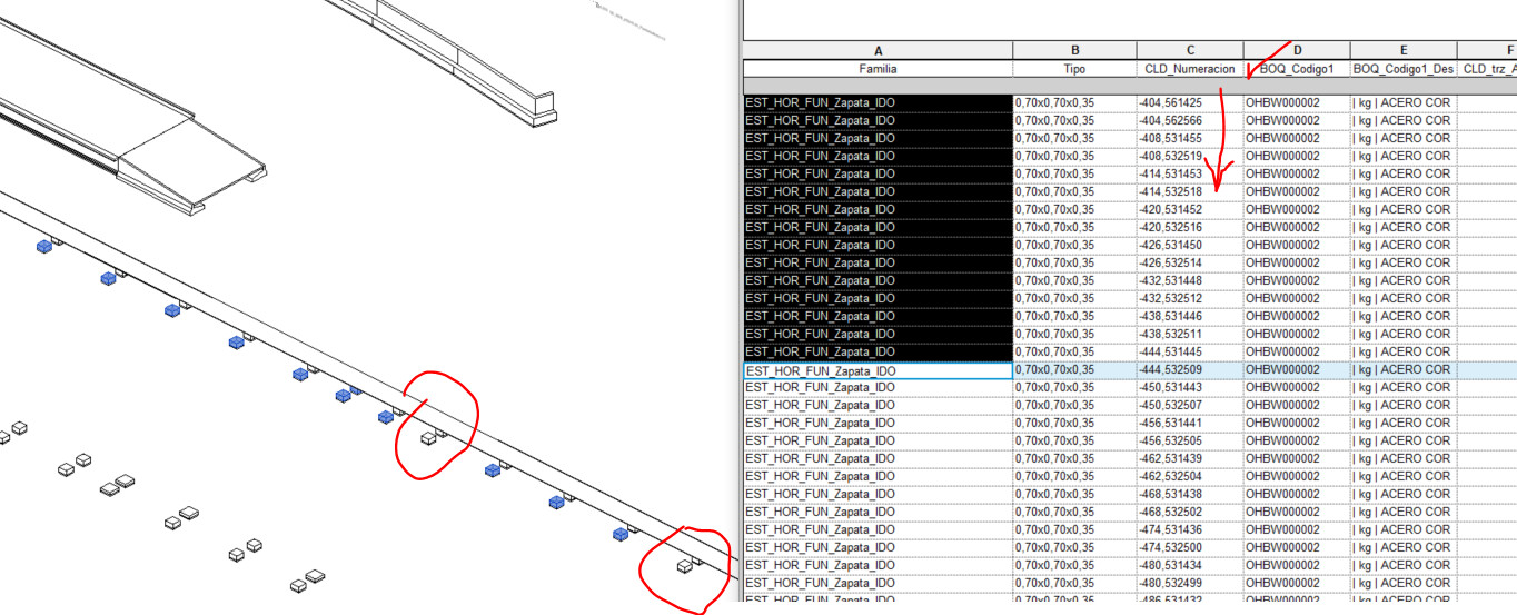

I have gone a little further… I was able to put its x axis in each element, the problem is that I did not put the axis in an orderly way, that is, each object should have its own axis
It seems that you have put the data randomly

Good job working it out. There’s actually no reason to sort the data though since you’re writing the values back to the same element. If you want the schedule data sorted that would be controlled by the schedule, not the Dynamo data.
