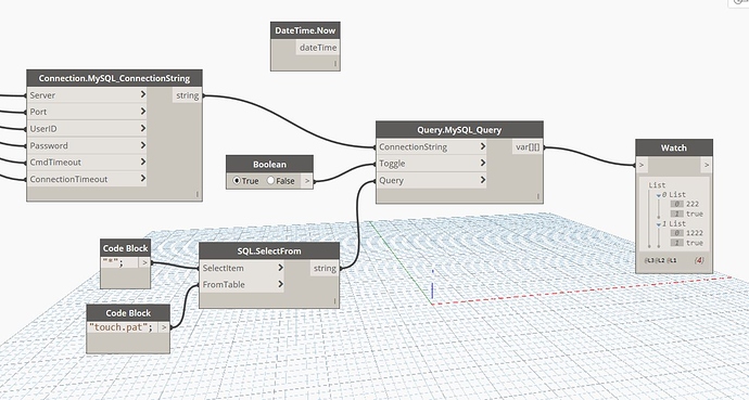

I want use Dynamo’s Slingshot package to connect mysql, that successful as shown below picture, but when i edit mysql data that can’t real time update to dynamo, must reconnect
node before it can update.
i found the DateTime.Now node, it seem to like can help loop read mysql data to dynamo ,but i don’t know how to use this node, can anyone give some suggestion?

Sorry, i have uploaded picture.
Try adding a waitfor node that is triggered by the DateTime.Now node and returns the Server before the server input.

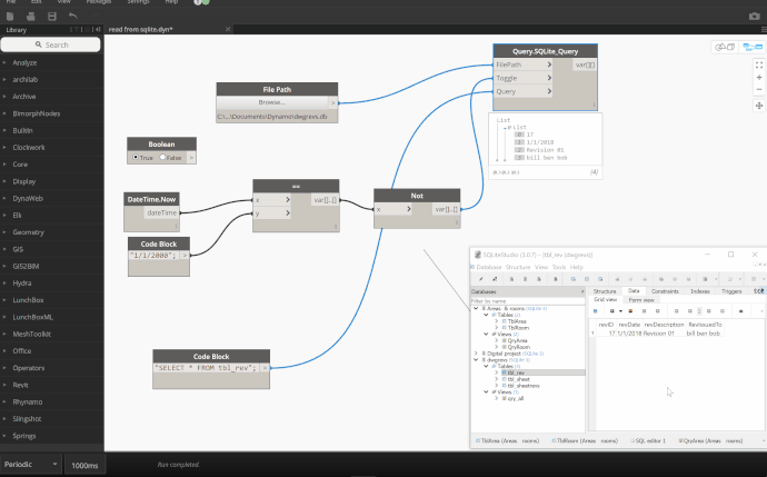

If I understand properly, the issue is that you need to toggle to boolean input to Query.MySQL,Query to force an update ?
You could do something like this (note periodic run in Dynamo)
A separate problem might be the ConnectionTimeout in the connection node
Andrew
I don’t know if the animated GIF is displaying properly, in real life it is updating every 1000ms
