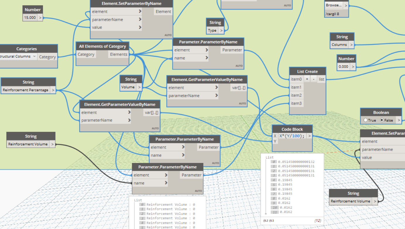

Cant get the number from my code block into my revit and string "reinforcement volume"
how do i fix my node ParemeterByName of reinforcement volume to show me the full code block results i got (after decimal number) it doesnt update it self in revit so i dont get the full result
I think springs package has a more robust setparametervalue by name node. Maybe try that one. Or is a rounding issue? Or is it expecting a string or an integer or a decimal point number?
tnx for the repply i worked it out by chaching the project paremater
