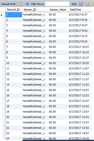

I am going to update my Revit parameter using " Element.SetParameterByName" node. I read and extracted the value from an external database through Dynamo, but as you say in the attached image, it was string. Therefore, I used “String to Number” to convert the string to a number. But as you see when I connect “String to Number” 's output (number) to " Element.SetParameterByName" node, it gives me error. It doesn’t work. Could anyone help me please? Since for establishing some conditions in my Revit model by Dynamo in the later steps, all string type values need to be converted into the number, otherwise the condition statements will not work. Your help is kindly appreciated in advance. Thanx

I got these values from MySQL database, assign them to an object in revit, then got these values using “Element.GetParameterValueByName” and assign it to its corresponding room.
