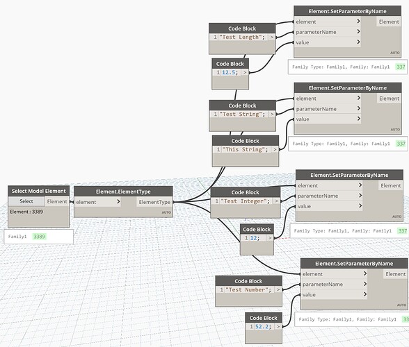

I am trying to set a “Number” (i.e. a double or integer) data type to a family parameter value in dynamo, but I keep getting an error message. The parameter in the family is a number not text.
Any ideas? please see the attached image:
It seems thagt parameter is expecting a string (“1x3”) and not a number (52.2).
“52.2” should work so you need to convert the data type (String from object for example)
Thank you, the parameter in the family is a number not text so it is not a string. Although I did try your suggestion, it still didn?t work

Thank you, I am using Revit 2021, the parameter in revit is a simple number, a double, it has no unit of measurement designated. The Dynamo functions I used just refuse to set double data types (a number) into a parameter in revit. I have no idea what the error is saying it doesn’t make any sense to me.
Could it be that this parameter is an integer? What if you try 52?

Sorry didn’t have a chance to send you the files yet, I am in a project. It is an issue I am having in general. I made a simple generic family to test it. It has a number parameter and a text parameter. I load the family into a project and run a Dynamo script to set these to parameter values. The ‘Number’ parameter is not allowing Dynamo to set a value there, any kind of value, not a double or integer, I even tried a string just for the experiment, nothing works.
