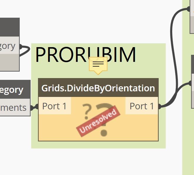

Cannot identify node "Grids.DivideByOrientation"
Hello I am looking for this package I am currently using Dynamo version 0.9.1.4062 I can not find it in the package server can anyone else

The node is from the package “Prorubim” as it actually says on your screenshot, also have a look here:
I simply searched the forum for “Grids.DivideByOrientation”

Remove pnid modeler from your revit installation /addins folder. That will solve your library issue.

@s.rooble Try installing Dynamo 2.01 from latest daily builds. Click here to download http://dyn-builds-data.s3-us-west-2.amazonaws.com/DynamoRevit2.0.1.20180524T0851.exe
I believe I need revit 2018 for the dynamo 2.0 to work because the previous version of dynamo works on my 2017
No you don’t. Uninstall Dynamo 2.0 before you install 2.0.1. It works for Revit 2017 as well.
