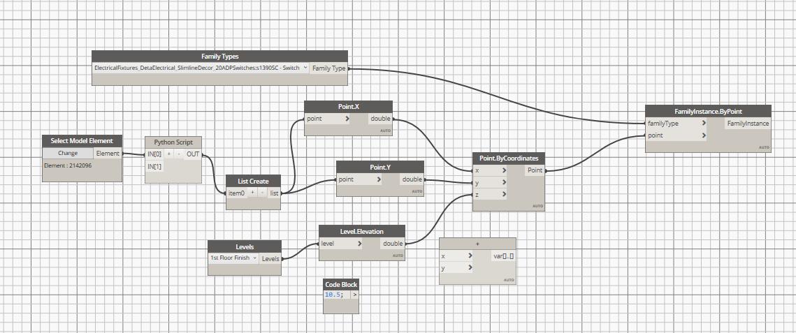

I have design a script for placing elements at the points. These are elements are not hosted. What problem I am facing is that after placing elements using script I am unable to paste (at different level) or move vertically. I am attaching my script also my python code for calling out the points from CAD LINKED FILE.
Please help me.
Placing Lights in PNS SHIFA.dyn (15.3 KB)
