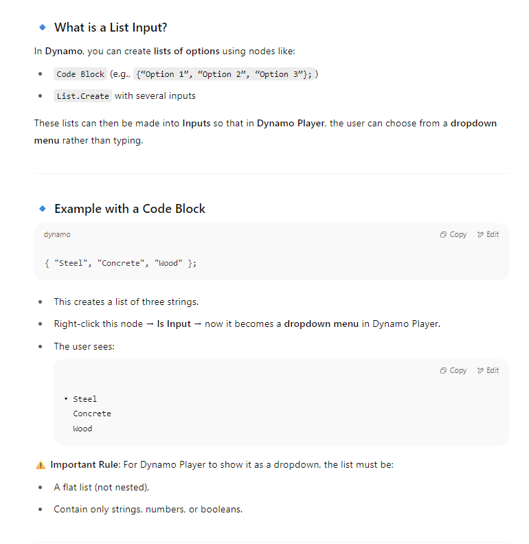

PS: ChatGTP seems able to read people most intimate desires, and then just shots out feasible solutions…. that do not exist.
Here it is claiming that a Code Block can be turned into an Input for Dynamo Player:
This can only be done using custom zero touch nodes currently.

Everything Gavin said is perfectly on point, so likely it answers your question. I can try to expand on anything if needed though so feel free to ask follow up questions.
The only thing he missed is yes, all the AI solutions built on large language models always hallucinate solutions. Even the ones which exist are produced this way. This works better for soft stuff than technical stuff, and for technical stuff with large collections of publicly accessible code (web development), but not for many things in AEC. The exception is tailoring the model to your use cases - stripping out the stuff that trains it which isn’t helpful and packing in extra stuff which is helpful. However developing such is a full time job and all of them need a ton of resources, so… I find them best to avoid for most use cases and google or search the forum.
