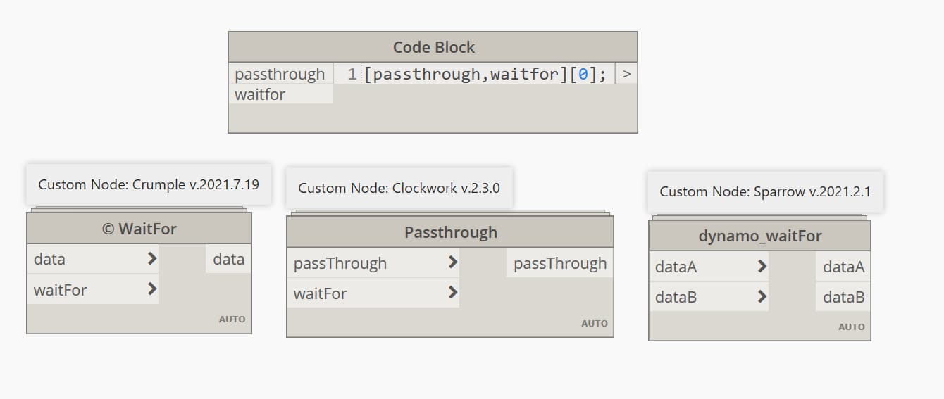

If you show your script we can do some modifications. Might need to add some await node.
Try passthrough/waitfor/await from clockwork/crumple/orchid respectively.

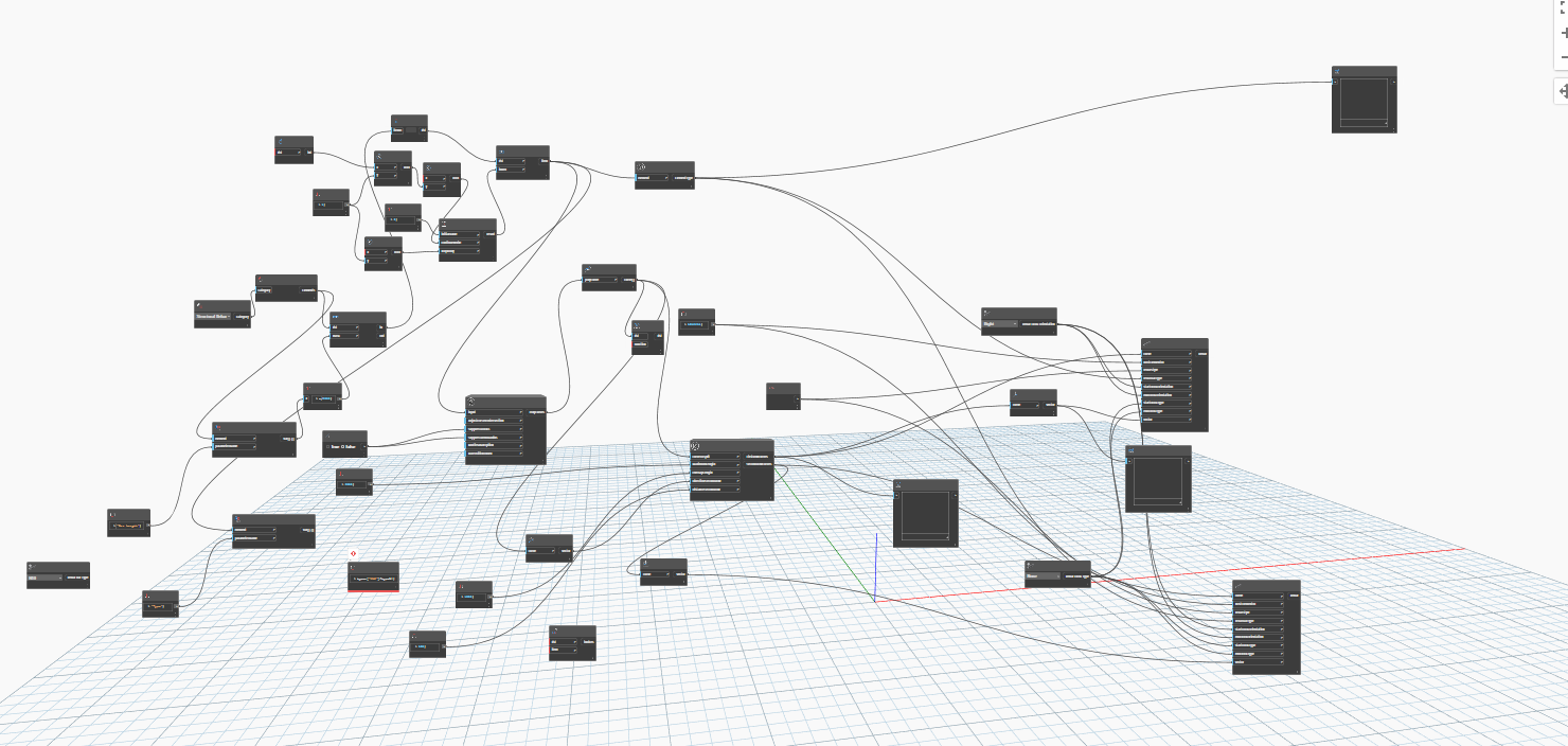

I have quite a large script which all needs to run before another event. How would it be possible to let it run before the second script is executed?
Hello @technitutors …we cant see your image try to zoom in…btw please create a new topic as this one is already solved…thanks
Yes I understand it is solved however it still contains the topic of pass through nodes and rather having someone else comment on it and eventually not get to a solution it would be much better to comment on a topic which multiple know hows have commented on to get their attention. If I start a new topic, I am just rolling the dice on the first person to answer my question, and whether his answer is a solution
