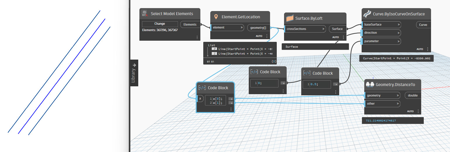

Hi, I am trying to model ducts from a CAD file. I have a script that models ducts from lines; however, in my current CAD file, the ducts are represented by their actual 2D width (two parallel lines). Because of this, my script models two separate ducts of the same size. How can I update my script to recognise these two lines as a single duct with the correct size? I have attached the snippet of script and my CAD. Also, there is an example of Duct modelling using my old script.(I have imported my CAD into Revit)

Hi Sovitek, after testing your script, I’ve noticed that the faint blue line resembles the model’s geometry.
