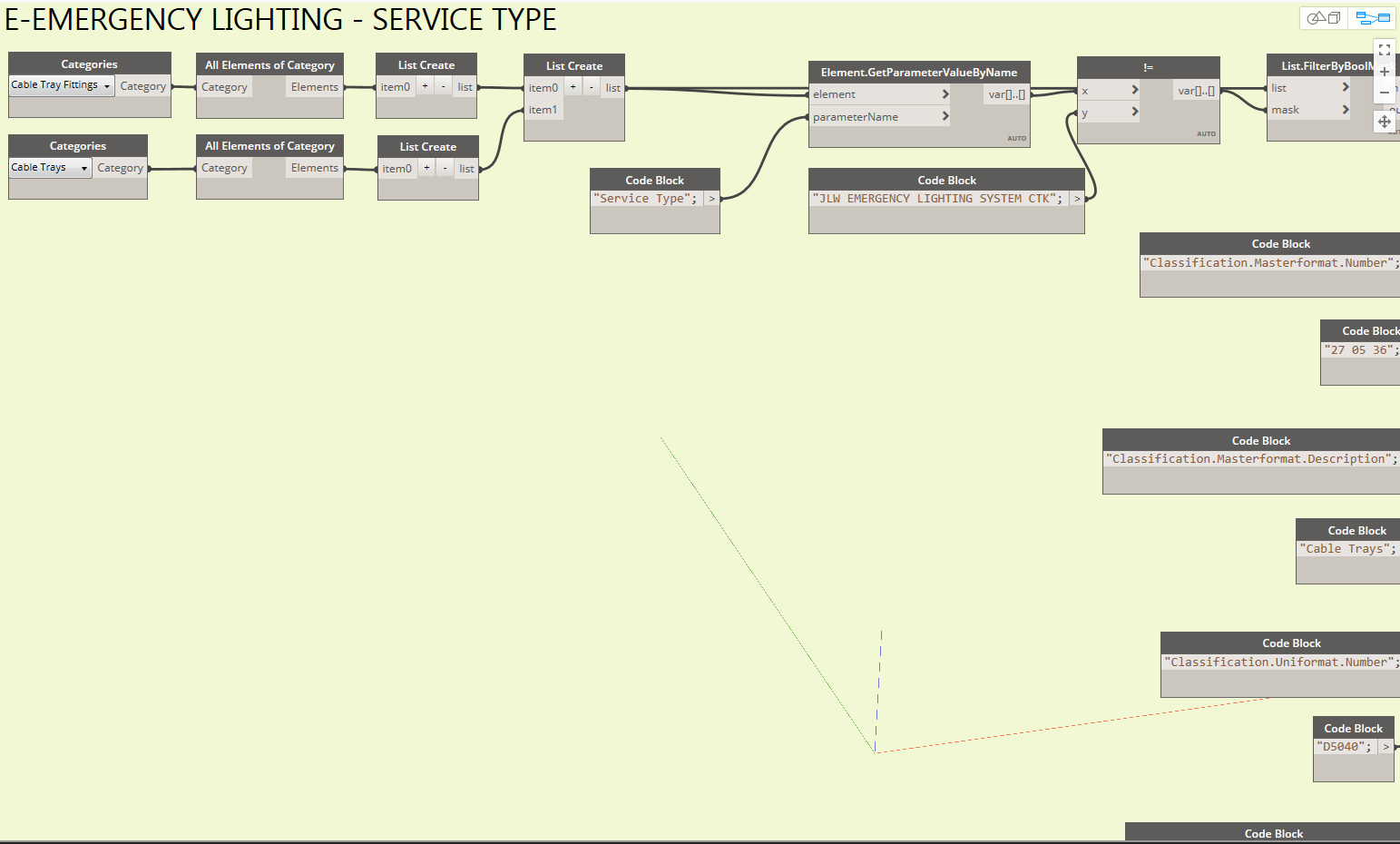

Can anyone give Me an idea how I can select Cable Tray & Fitting Categories by Service Type and push or set a parameter values to all similar Service Type only?
I was successful doing the same exercise for Ducts & Pipes (using the System Type) but it didn’t work the same way for Cable Tray.
This thing works but it applies to all Cable Tray of all Service Type not the specific type I want too.
