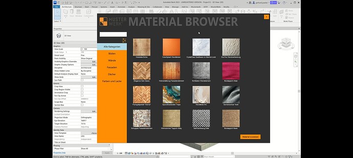

I think you can create awesome ui’s with winform, here’s one of my recent ones.
I recommend this awesome youtube channel, there are many UIs created with explainations and you can find all the code on the homepage!
