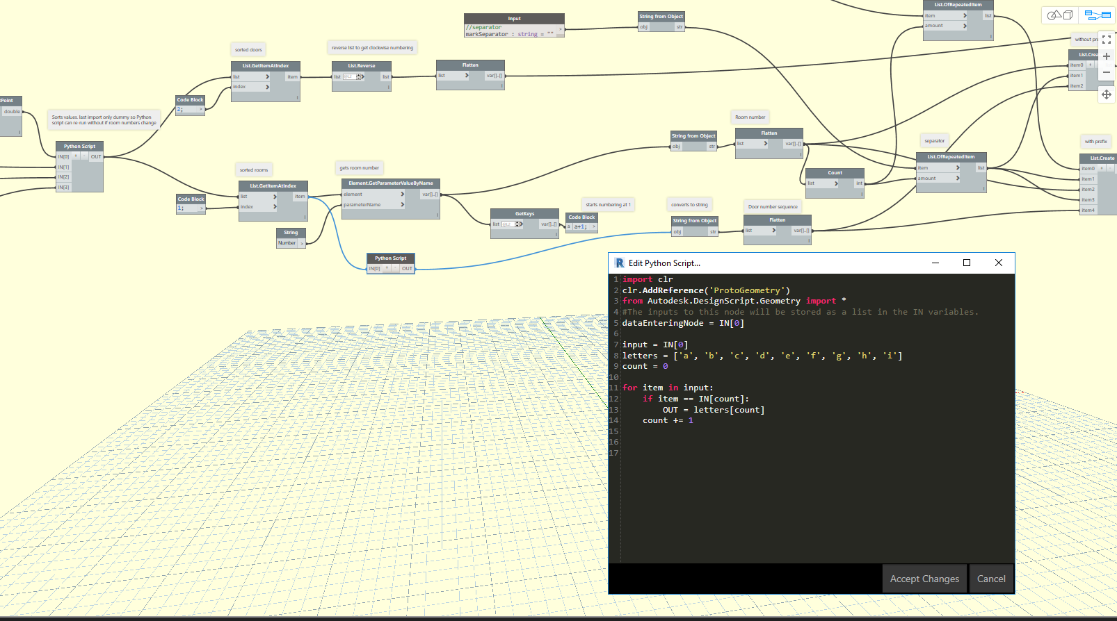

I am trying to modify the BVN package’s node “Door.RenumberByRoom”. The node works very well, however I want the suffix to be letters going from a-z rather than numbers. Here is my current thought process.
I open up the BVN custom node. The area that I think I need to modify is here,
I then make this intervention with custom Python code.
My code reads:
#The inputs to this node will be stored as a list in the IN variables.
dataEnteringNode = IN[0]
input = IN[0]
letters = ['a', 'b', 'c', 'd', 'e', 'f', 'g', 'h', 'i']
count = 0
for item in input:
if item == IN[count]:
OUT = letters[count]
count += 1
Could anyone please steer me in the right direction or give me an easier solution? My goal is to add letters from a-z rather than numbers as the door suffix. I appreciate the help!

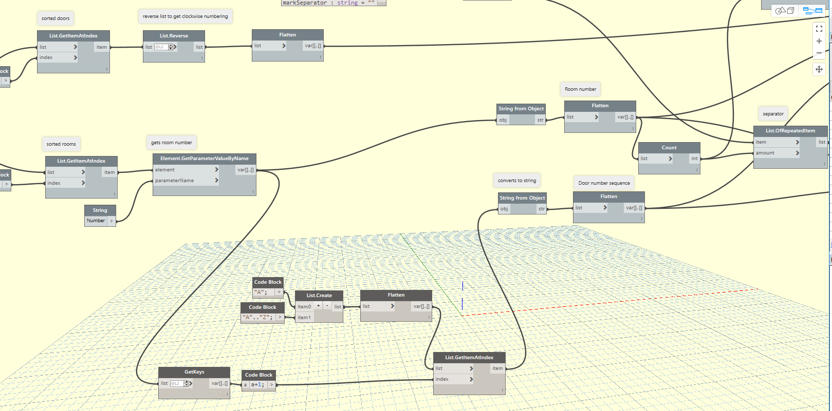

Hi Christian,
I think you have found the correct point in the node to modify, however I would approach changing it differently.
I do not have the package currently, but I assume the Key they are getting is outputting a list of 0 through to the number of doors in the room.
If this is true, I would use the attached image as a guide.
Thanks for taking the time to help @i.shaw! This was able to get me part way there. The suffix now updates to letters, however there is inconsistency with how it is appending those letters. I believe the problem stems from the code block with ranges {0…3, 0…2, 0…4}. In some of my rooms my door marks begin repeating. Is there a way that I can modify this so that it detects how many doors in a room to add the letter suffix before repeating back at “A” regardless of the amount of doors in a room? Thanks again.
Sorry Christian, take the Code Block Node in the original definition that has “a+1” in it and plug it into the ‘List.GetItemAtIndex’ Node instead of the {0…3,0…2…} etc. Node. It was just an example.
That did the trick! Thanks again @i.shaw! I had to make one modification though. The a+1 was starting at the “1” index so my first letter being appended was “B”. In Python I know how to solve this, but to get it to work in Dynamo I just added an extra “A” at the beginning of the list so that index 1 came out as “A”.
Not too elegant but it worked like a charm!
Take the ‘+1’ out of the ‘a+1’ Code block, then you will not need to add an extra A.
I encourage you to copy / paste the nodes to a dynamo definition and check what they are actually doing!
