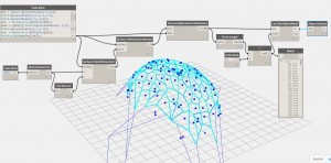

Hi It’s Christmas Eve and i have some (noobish) geometry problems. I created a voronoi on surface and I have no idea how to cut all the extents and stay only with the geometry I need. In my case they are around 40 kilometers long :slight_smile:
Happy Holidays everyone!
1 2
Hi Viktor,
Why not query the curve’s length and discard the ones that are over a certain realistic limit? Happy holidays :slight_smile:
Capture
Thanks, Dimitar.

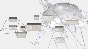

I tried it and in the lists everything looks fine to me. Though when i try to create sweeps over the curves it gives me some strange results. dyn1
Hey Viktor,
What method are you using to create your sweeps? I recommend “Solid.BySweep”:
2014-12-26_181433
Previously i used surface.bySweep. I tried it with solid now and the results are identical.s1
I found a mistake. I was keeping the path for the sweep from the unsortet nodemistake
Thanks a lot, Dimitar.
