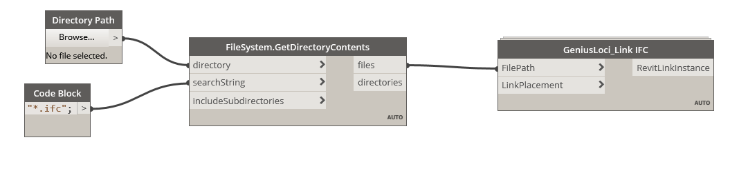

Hi @acontreras,
There is a Link IFC node in Genius Loci package that allows you to link IFC files in Revit.
I’m not sure it fits perfectly your workflow.
