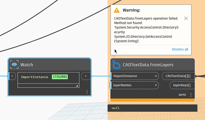

I have upgraded a project to 2025 and installed the latest Bimorph package but I’m getting the below error on the CADTextData.FromLayers node. This was working in the 2021 project.
Revit 2025
Bimorph 5.1.3
If you still have access to 21, you could run it in 21 then export the textural data and re-import it back to 25. No one knows if the author will target .netcore (a major shift starting from 25) and rebuild it once.
