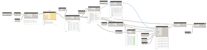

Hi, I removed my Python script to create a ViewSet instead I select the ViewSet which was already created outside of Dynamo. Still no luck creating the PDFs though.
20.03.16-SPFILE-.txt (1.5 KB)
a1 test title block.rfa (500 KB)
testing printing pdfs Plan B #5.dyn (79.1 KB)
Try to simplify your graph to find the culprit.

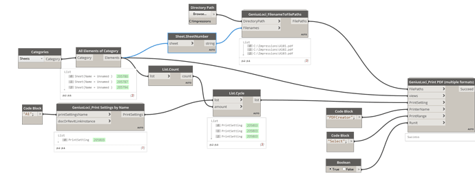

Here is a simple example :
Batch Print PDF.dyn (21.2 KB)

The input must be a view element preferably a sheet :
sheet
You can’t use sheet number or sheet name for this input.

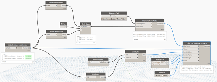

So I have been looking at this print to pdf for awhile now. I currently have RTV Tools which does what I need at a cost of course. But what I am struggling with and have found. Is that if I try to put in the Sheet Name after the Sheet Number if does not finish its run.
Your graph seems correct and it is working for me with Adobe PDF or PDFCreator.
Unfortunately, I can’t test with Bluebeam PDF.

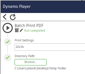

Then you have Dynamo Player. It sometimes prints and sometimes doesn’t…But never errors out.

With most virtual PDF printer (PDF24, AdobePDF), you can set a fixed output folder in the printer properties.
With PDFCreator, you can dynamically determine with Dynamo the output folder.

I am trying to do the batch print across multiple projects but am new to Dynamo. I’ve followed along your graph and ran into this error message. Is it possible to do this batch print across projects if they are central files and not local? When I switch the connection from filepath to detachfrom central on the Applications.OpenDocumentFile I get a null result at the end. Any tips on what I am doing wrong here?
