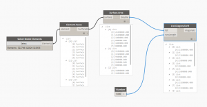

Guys,
What should i do if i want to get the result of each list from surface.area ? right now i think its only check the first item. I meant to get the wall surface here.
Thanks guys

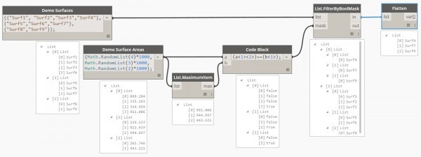

Hi Hagani,
I think your looking for this:

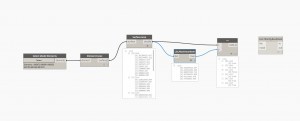

Hi Kulkul thanks , tried that but didn’t work not sure why.
Vikram, thanks again, works perfectly !
