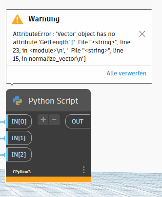

I’m trying to scale down the length of my vector and so I have a python script that takes a vector as an input and normalize the vector and multiply it to a scale factor.
I have an error notification from my python script that says the following:
Screenshot 2024-03-01 120009
Although i know that in the revit api docs, there is a method GetLength() for Vector (see GetLength Method (revitapidocs.com))
I’m not sure where the mistake lies, but here is my python script…

The problem is that the vector object is of type Autodesk.DesignScript.Geometry.Vector rather than the expected Autodesk.Revit.DB.UV or Autodesk.Revit.DB.XYZ type.
To fix this, you need to convert the vector to the appropriate Revit vector type before using GetLength() .

My guess is an Autocomplete or ChatGPT lead you astray here.
For length of a Dynamo vector you can use the Dynamo property, length = vectorObject.Length.
Thank you for the insights!
haven’t quiet fully comprehend until now that Dynamo’s geometry and the geometry from the Revit API are two separate things :sweat_smile:

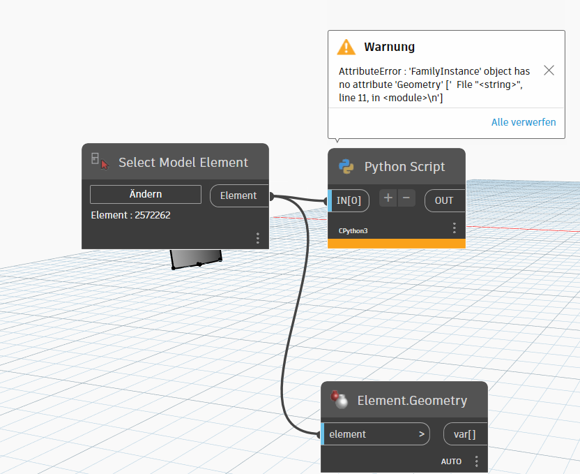

how does this work for other types such as elements?
I wanted to recreate the Element.Geometry node but it also results in the same error

UnwrapElement deals with converting from a Dynamo element to a Revit API one. :slight_smile:
In this case you’re not providing a Revit API call, but you converted to a Revit object (hence the unwrap element line). If you don’t unwrap you can use the Dynamo Revit element property like that, but if you are going to unwrap you need to use element.get_Geometry(options).
To see what you can use on a given object try OUT = dir(object) which will pull all methods for an object. From there you can call for the documentation via OUT = object.Method.__doc__ where method is something from the dir(object) output.
