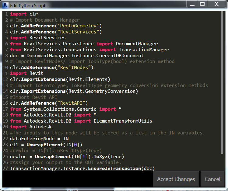

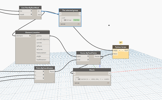

I took out the location of the group (Revit element), then construct a vector, then move this Revit element inside a python script. However, I have a problem in converting Dynamo vector to Revit vector which is Revit XYZ. I attach the photo of the script here.
Error:
IronPythonEvaluator.EvaluateIronPythonScript operation failed.
File “”, line 25, in
AttributeError: ‘List[object]’ object has no attribute ‘ToXyz’
Thanks, Minh Chau
the overall code
The error is very clear, you are attempting to call the ToXyz() method on a list rather than a singleton. Remember Python doesn’t replicate like DesignScript, so you will need to use a for loop to iterate your input list and access each member.

As much as I admire your attempt to do this with Python, I don’t see why not just use the default OOTB nodes.
Point.Deconstruct is from Wombat package but can be replaced with OOTB nodes as well. Point.X, Point.Y…
