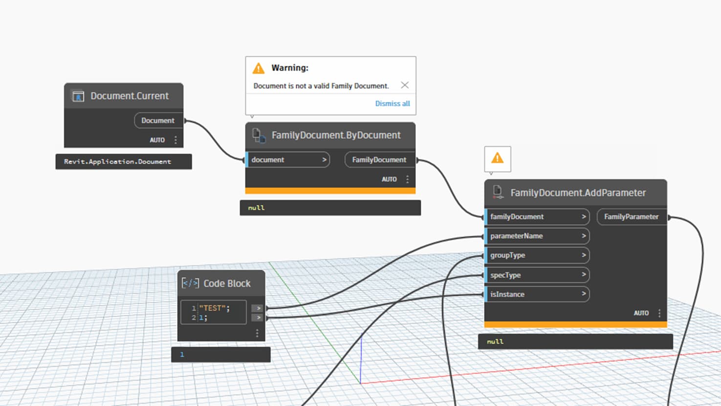

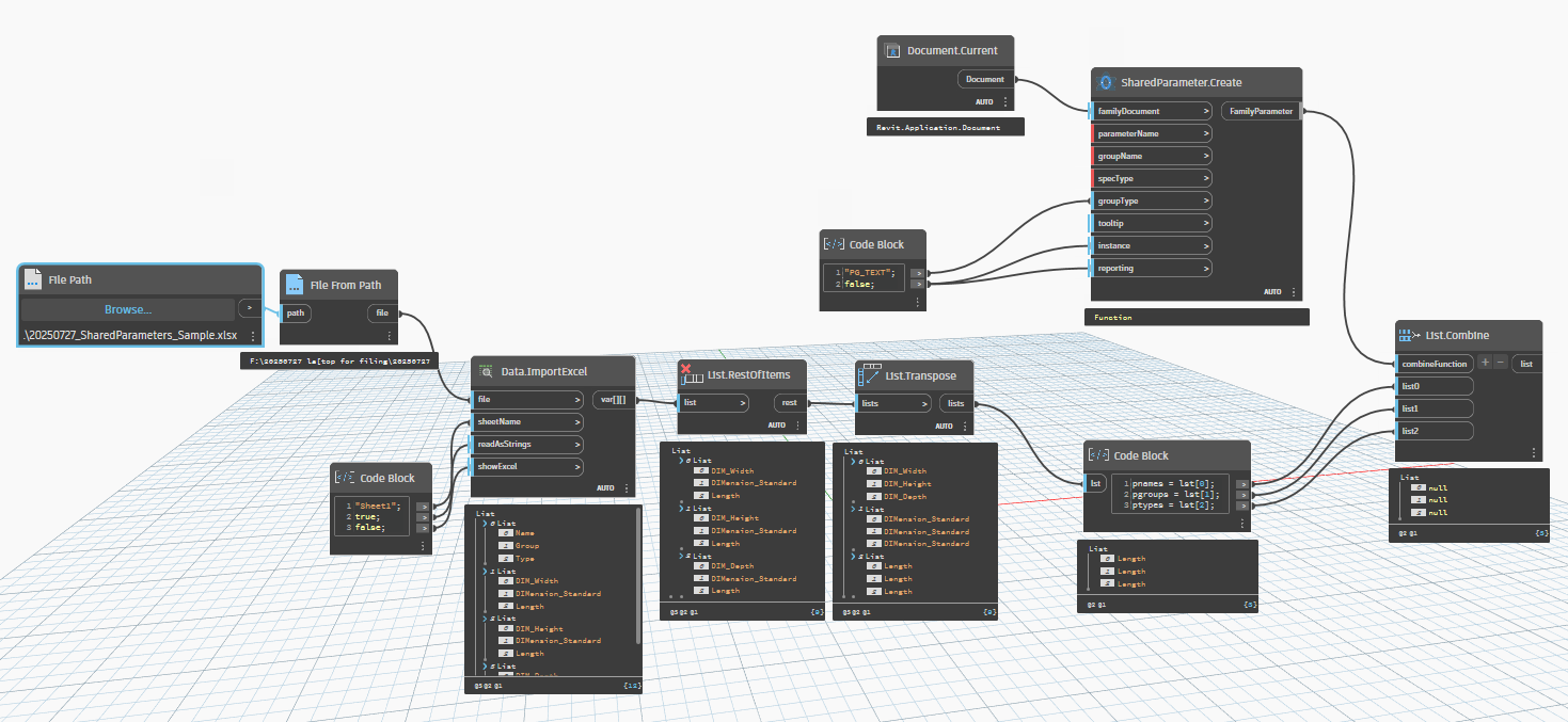

I am currently attempting to create a shared parameter using Dynamo. However, based on the attached Dynamo file and the snapshot provided, the graph is returning a null value.

Hi @RaymSanz i dont know that node..but seems its expect a family document, we have a ootb for convert current document to family document, and in 25 its specgroups, and spectypes and not PG, there are ootb for that as well
Hi @sovitek , thank you, it is appreciated.
I tried as per your snapshot, but I still getting warnings as shown below and I have attached the dyn file too;
25DYN_CREATING SHARED PARAMETERS FROM EXCEL WIP2.dyn (25.7 KB)
are you sure you are in a family document ?
Unfortunately i havent got that node to work in a while (i recognize the list combine, followed my tutorial i think).
I am working on a node for this in python for crumple. This is the key to creating a parameter:
Hi Gavin which version does it not work ? i guess you mean the family document node…
I made my tutorial back in 2019 using orchid i think, very old now. At the time erfajo hadnt added the condense system in so list combine worked nicely. I honestly never got orchid to really work as intended since then, which is what motivated me to make my own familydoc nodes.
At this point all i have left to add to effectively displace orchid is createsharedparameter and createtype. Addsharedparameter is in there if the author is in fact trying to add existing parameters vs create them add to the sp file.
åh ja, never tried that one, for shared family parameter i use yours;) or my own as goes in 2 step first add to txt file then create the parameter, thats how i like it…PS but my example was just for familyparameter as i dont have that node from orchid…
Hi @Gavin, thank you for your reply, much appreciated. Yes, this is based on your tutorials (and thanks again for all your videos, they’ve been incredibly helpful!).
@sovitek At the moment, I’m having some trouble with this part and currently testing it in a blank Revit project to isolate the issue.
You will need test in a family document
i tried with family document, I got null…
looks good :wink: i guess you have created the parameter
Yeah, it works! many thanks!
for adding shared parameters from Excel, still not working…
Yes in that case try Gavins nodes and guess the package is just updated :wink: :wink:
