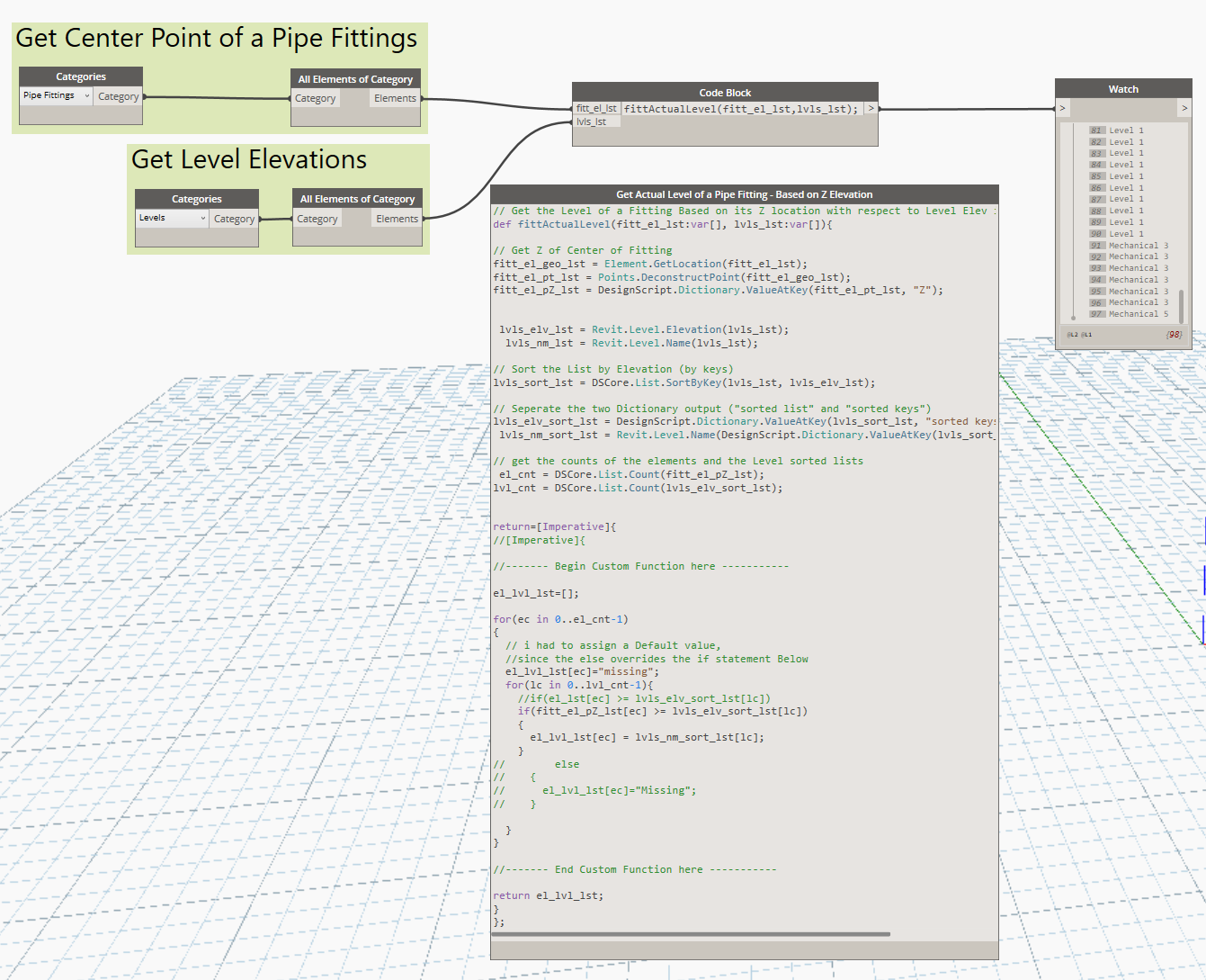

I think this is mostly a Design Script issue… i am still new at it.
i am trying to assign the Level of a pipe fitting based on its location with respect to the levels in the Document.
So i will compare its Z location with respect to the Levels Elevation.
As you can see below, i am getting “Empty List”. I have tried many things, based on the Forums, but i guess i am still missing something fundamental or this should not be an issue.
Can someone help me out see what i am missing?
thanks

Regardless, I think you won’t be able to extract the point Z of each fitting through a for-loop. If I’m not mistaken this is not a static method.
Maybe you can get the location and each Z coordinate out of the Imperative mode and then proceed with your idea.
Hi EdsonMatt,
It looked like the culprit was GetLocation. I could not put it in the imperative block. it complained about non static function. So i kept it above the imperative block.
The reason i did not see this is that warning message the first time around, before i submitted my question, is that i was building the code as a def function, and calling it as you see in image below. It was only when i switched to writing the code as in-line codeblock, and not a function call, did i start seeing these warnings… i am not sure if there is a switch for hiding these warnings. it would have saved me a lot of time if i did see them early on.
So here it is now, it gets the location of a Pipe Fitting based on its Location on the Z axis, regardless of what the Revit assignment for it is, in the properties window.
Thanks for your response,
