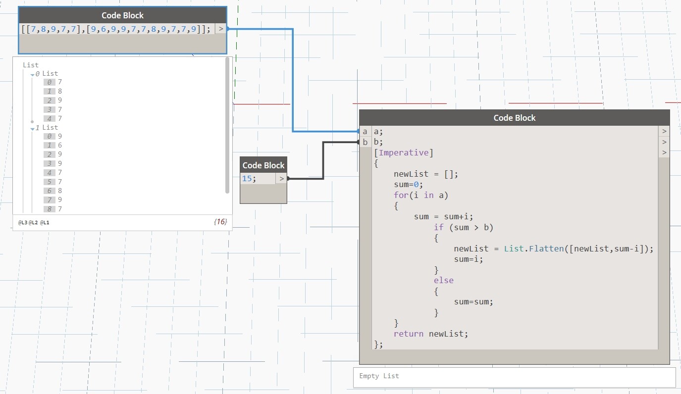

I have List and CodeBlock, When one List ,can success the Loop,But Level List ,return Empty List,I don’t know how can i do, Please help me,Thanks.

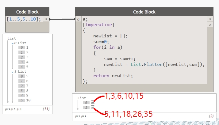

Example,one list can success the for loop,Level list can’t success for loop,it return Empty,but i want two sum list.

here is a possibility
code block definition:
def sum_cum(_List: var[])
Somme=[Imperative]
	s[];
	s[0]=_List[0];
for (i in 1..DSCore.List.Count(_List)-1)
	s[i]=s[i-1]+_List[i];
return = s;
return = Somme;
Cordially
christian.stan
Thank again christian.stan ! That’s it what i want !
I unfamiliar Code Block Loop,If i want rewrie that’s Code Block how can i do?
Thanks in advance.
Hello, here is an answer, I admit that I have trouble understanding what you are trying to achieve via this code block
(Afterwards, I’m not a strong person)
def sum_born(a:var[],b:int)
res= [Imperative]
	newList=[];
	sum=0;
	for (i in a)
	sum = sum+i;
		if (sum>b)
			newList=DSCore.List.Flatten([newList,sum-i]);
			sum=i;
		else
			sum=sum;
	return newList;
return res;
Cordially
christian.stan
Extremely grateful christian.stan,That’s it what i want !
