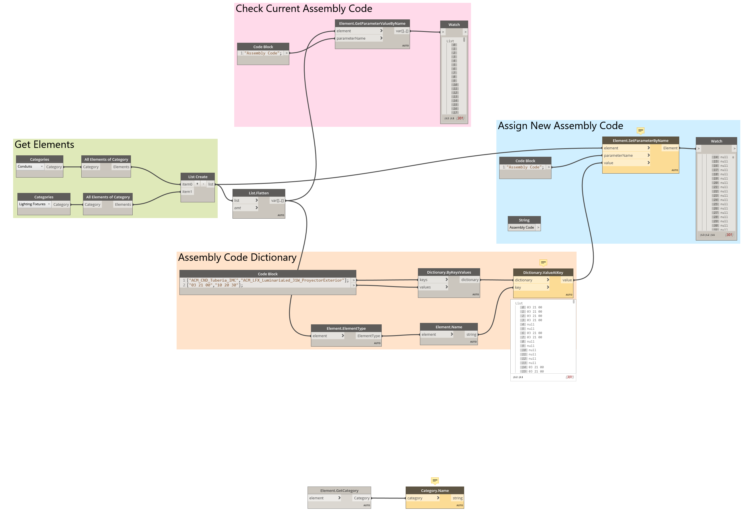

I want to assign a Assembly Code to all the elements on my model, so far I have figured out how to obtain the current Assemble Code (blank) and made a dictionary with the Values that I want to assign, but for some reason a I can’t set it to the elements.
Any idea what am I missing? or if is there any other way to achieve this?

The error message should explain the issue. Assembly Code is a type parameter, so you need to get the FamilyType from the instances you’ve selected and set the parameter on the FamilyType.

@Nick_Boyts Thanks for your help, I changed to Family Type and it worked! but for some reason I can’t see all the family types that are in my model (eg. Conduit with fittings:ACM_CND_Tuberia_Cobre) any idea of why is that?
Can’t see the nodes you’re using in that screenshot (make sure you’re zoomed in enough that node titles are visible before taking screenshots) but I’m guessing you’re using the Family Type selector. That’s only going to show loadable families and their types. For system families like conduit, you’ll have to use another method. Try using the Element Classes (Element Types in older versions) and All Elements of Class (Type) nodes to work with system types.

I used the Element Types Node and it worked but when I try to put it all together wit the Family Type list I get an Error on the Element Name and the Dictionary that says “Asked to convert non-convertible types”.
Any Idea how could I mix both types of families?
This usually means that a nodes is trying to do something to an invalid object type. In this case, you’re feeding the ElementType names rather than the elements themselves. You can get rid of these unnecessary nodes:
I’d also recommend using the flattened list for everything (which doesn’t need any list levels).
That solved it! thanks :slight_smile:
