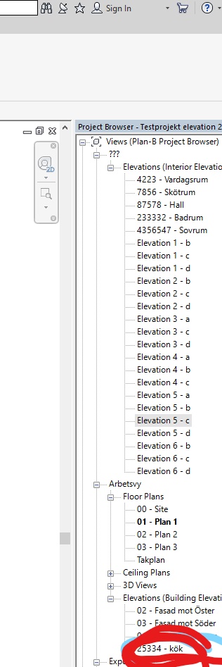

I’m trying to rename Interior elevation-views by room name and room number by wich room the elevation marker is in. I dont know how to add a suffix that seperates equal names since i’m getting the message “The name entered is already in use. Enter a unique name.”. I have four views in each room. thanks’s in advance.

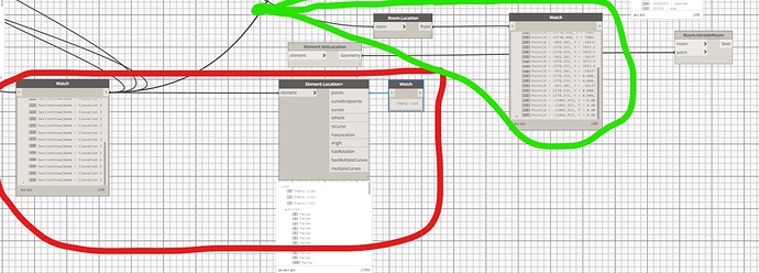

As i’ve continued to test different solutions i’ve come to realize that there’s more than one problem with this script. for example it dosn’t seem to only get the interior elevations.
As you say, your initial filter does filter the interior elevation. As the data is coming from your out port i assume all the returns into your list were false? So none contained the word interior?
Additionally, what are you trying to achieve? Applying the name to “Title On Sheet” will allow for duplicate names? Whereas View names will not, both processes you are attempting.
Finally, how are you trying to assign the correct Room Number to right elevation name? As in, what is the relationship between the two lists?
