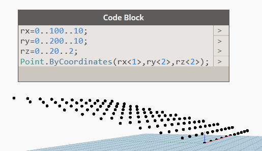

I am trying to create an array of points on a slope. I have been able to create the array on one z plane using the ‘Cross Product’ Lacing. I have also been able to make a slope using the z when changing the Lacing to ‘Shortest’. My question is how to progressively step up the z coordinate but in the ‘Cross Product’ Lacing style array?
Ok, I’ve been able to get a clumsy result. Still wondering if I could have a ‘rows’ and ‘slope’ or even ‘z step’ node…
Using replication guides …
Thank you both, very efficient solutions!
Thanks to you both I was able to iterate this array graph to include a true slope angle.
