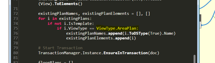

Hi Mauro!
Your edited areaplan.byarea now almost seems to work! :slight_smile:
It manages to create new area plans but only for the first floor areas if you have that area plan open.
Do you have any clue to why?
