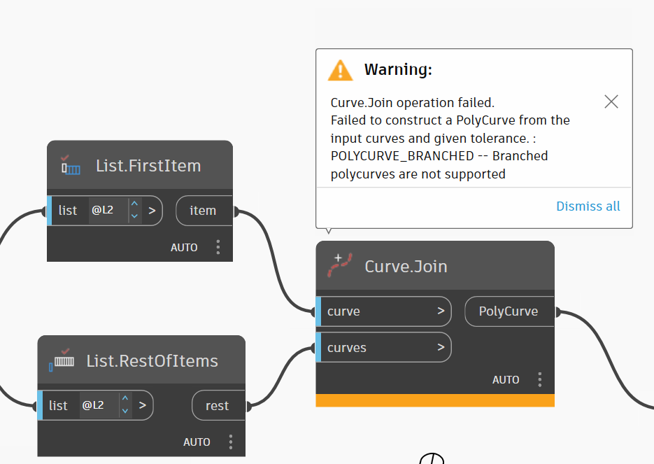

Your suggestions works, but I found that in situations where the surface is double sloped there appears an error when joining the curves.
This is how the situation looks in the model:
An this is the error in Dynamo:
I will mark your reply as the solution. For this error i will just have to figure what to do.
i think it is Listlevel …
you can level your list also in the node Curve.Join…
the aim is to make with the lines a polycurve → surface.Batch - > x.Area
KR
Andreas
will check. Thanks again.
