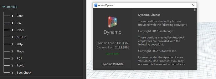

Archi-lab.net node to work with Revit 2023?
anyone get the archi-lab.net node to work with Revit 2023?
Currently the supported versions seem to top out at 2022. Give it time. :slight_smile:

I have most of them worked around the one I am trying to fix is the Select.ByElementID and the Views.GetByType the other one I did get a fix was Sheets Is A Placeholder. below is the code for that one.

UPDATE:
Konrad is working on this now:
On the package manager now! @Konrad_K_Sobon posted the update a few moments ago:
