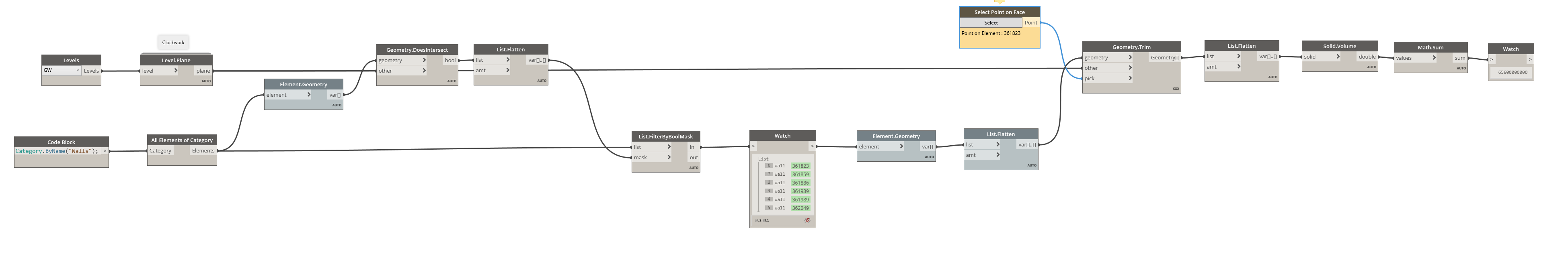

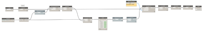

Analysis for uplift - Get volume information below groundwater level
You need to add your stablilizing filter to this and also figure out how to find the elements that are modelled completely below the GW level.
The Point is any point above your GW level to indicate the above volume should be cut, you can use any other method to generate a point there. (maybe use the Z value of the topside of the intersecting walls?)
