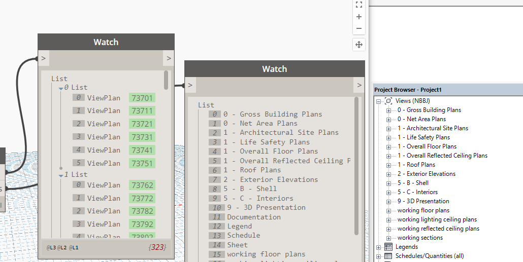

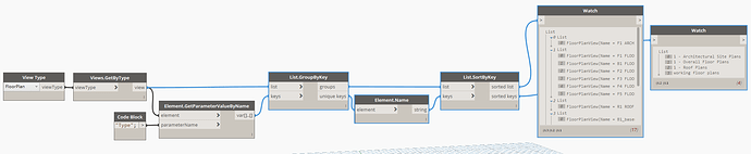

I was looking for a way to get the views of a ViewFamilyType but I cannot seem to figure it out without grabbing every view of a Type.
Every floor plan view in a project grouped buy ViewFamilyType. From here you would just need to grab the correct sublist.
This method will grab and group every view in a project.
You can see here that it matches the project browser.
What Kulkul posted should work for you. I was doing something similar and wanted to dive a little deeper for my own development. I was hoping to find a way to directly use ViewFamilyType but I don’t think anything has been developed. I will save the API dive for another day.
