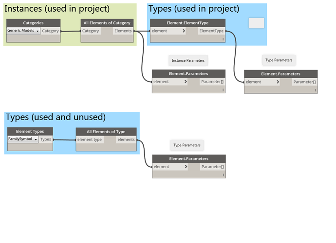

Hi @carmine.lb,
This is how you can select unused Types (lower graph).

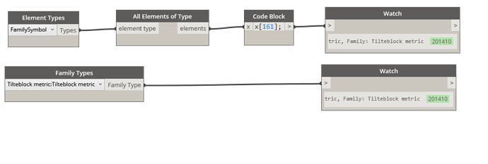

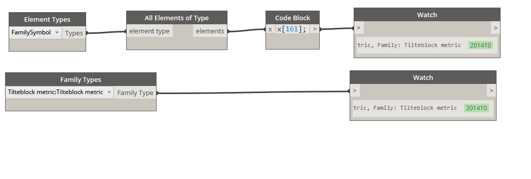

You can also use the node Family Types to find the correct unused titleblock family type.
Yes Alban,
I thought of that, but I needed a broad solution for the user to give. I think @MJB-online post should be the one i was looking for… I’ll give it a go… thanks!
