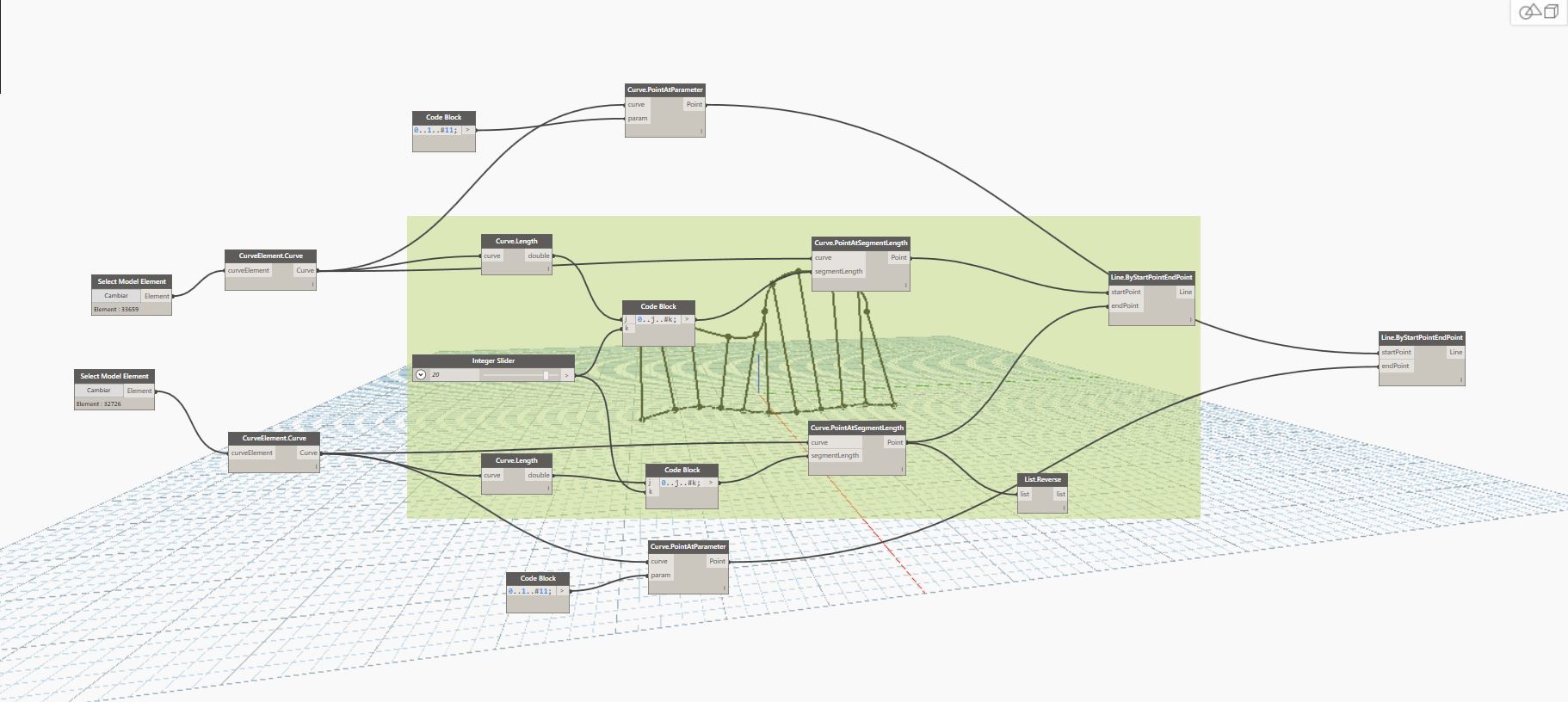

Hello everybody, just wondering, how can i align these lines so they are nice and straight, considering there two different curves?

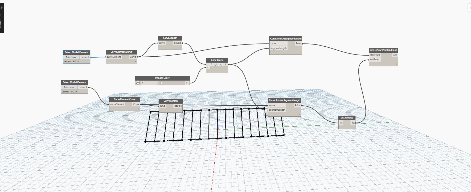

The green group is another method that i tried but no good

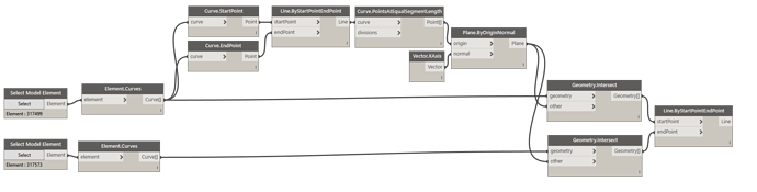

If you want your lines to be constrained to a plane, you’ll have to intersect the two curves with that plane and join the points. Here’s an example with the YZ plane:

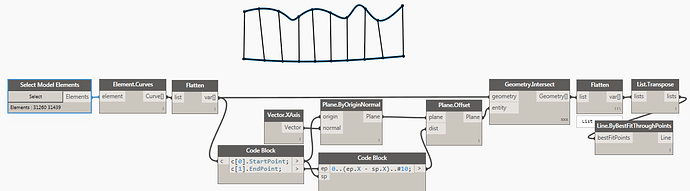

@pablofederico Something like this?
BridgeCurves.dyn (10.0 KB)
thanks both of you, it worked by intersecting the planes !!! I m starting to like dynamo more and more now that i can understand it a bit better
