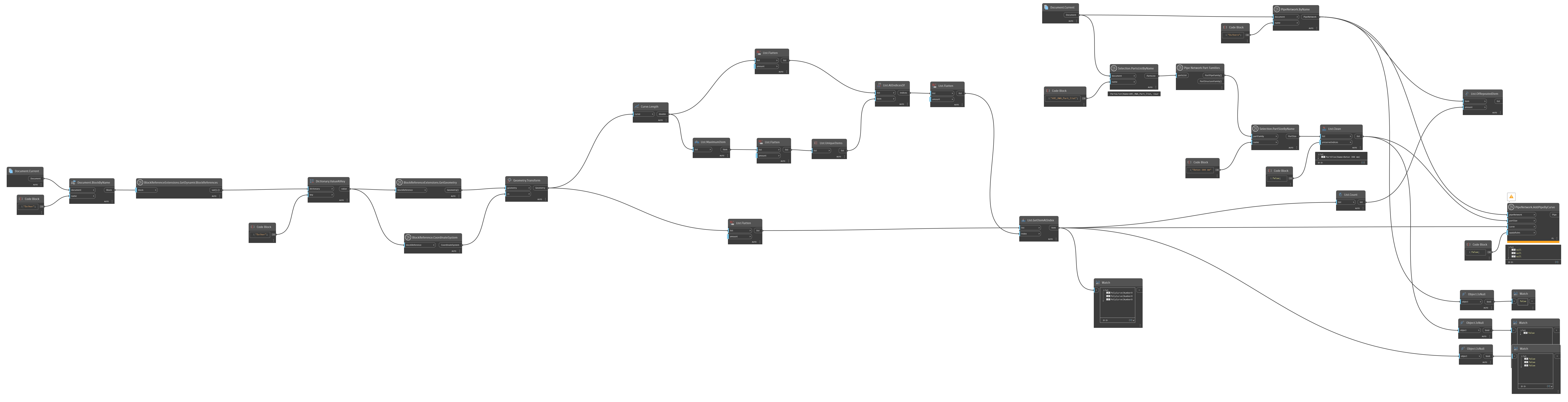

Hi all,
I ran into a problem with this dynamo graph. An error most of you have heard/seen before:
‘Object reference not set to an instance of an object’
In this case for the ‘add pipe by curve’ node (civil 3d toolkit).
The graph (should be) doing the following:
  1. Get geometry from a block by name;
  2. Filter out the longest line;
  3. Create a pipe base on the line.
Later I want to add attributes to the block to select part size and maybe elevation.
I checked for null values and couldn’t find any. Do you have any other suggestions?
It might be obvious, I am still pretty inexperienced in dynamo.
Looking forward to your suggestions!
Sincerely,
Jochem
@Paolo_Emilio_Serra1
@Anton_Huizinga
Dynamo-C3D_Duiker-naar-3D.dyn (63.9 KB)
u cannot send polycurve, it only takes curve
Thank you, this is it!
I’m sure I tested this before, but there must have multiple things wrong then.
