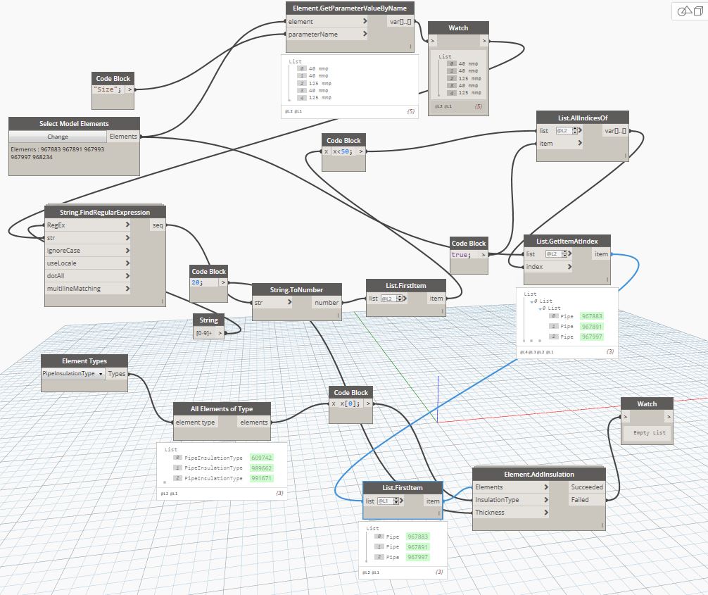

I want to add insulation to specific pipes. When I am directly connecting select elements to add insulation it is working.
But actually, I want to filter by size. So when I connect “list.getitematindex” node to “add insulation” node it is not working. Please give me a solution.
Try changing the Level of the node to L1 or L2 (on the ‘Elements In port’).
I tried changing levels, but not working. I didn’t understand which is “elements in port” node in my graph.
thanks
Its solved by your instruction.
Good to see you’ve got a solution. What I meant was this btw:
Another option would have be to just use a flatten node
yes, its working. Thanks for your response.
