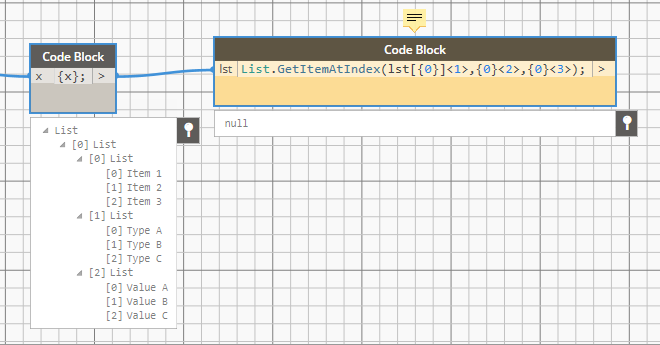

How would I access multiple items in nested array within a code block? Is it possible using the shorthand syntax below? I have been able to access multiple items from a single array within the list but neither Single or multiple items from multiple arrays . Thanks

One more questions Vikram, are the values in the <> defining the list level? As is I add another level of nesting to the list and then copy add , {0}<3> it fails
Msg warning Balloon says “Warning: Cannot find static method or constructor DSCore.List.GetItemAtIndex()”

List.GetItemAtIndex requires only two parameters/arguments - list and index
List.GetItemAtIndex(list,index)
So providing three arguments while calling the function results in an error.
The numbers within the angled brackets are replication guides. You can read more about them here
